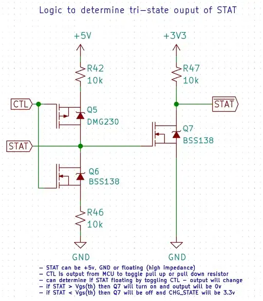

I also am using the MCP73831 and wanted to connect STAT to an MCU that only accepts 3.3v on its input pins. I was also worried about putting 5v on an GPIO pin.
Rather than using a voltage divider, I used a second GPIO pin of the MCU to toggle a pull-up / pulldown resistor using a P-Channel and N-channel MOSFET (see circuit below - I think this is called a totem pole ;-)). I then took STAT and put it through a simple inverter so that the MCU could safely read it (ie ~STAT between 0 and 3.3v).
For this to work, I then took 2 readings of the output (~STAT), the first with CTL low and the second with CTL high. If the readings change, then STAT must be floating. If you needed an LED to display the charging state, you could then control this from the MCU itself if you have enough spare GPIO's :-)
Hope this helps. enter image description here
