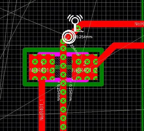

Therefore, the following connection is used: A resistor acts as a bridge... The resistor is serial connected for matching purpose. Is this kind of connection valid? I dont like it as well, since the resistors are in 0402 package, which makes the trace through very thin. enter image description here

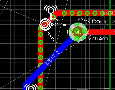

One last question, should I worry the interference between different signal traces, if the following connection is used (with vias)? enter image description here

The suggestion shown in the first diagram, isn't a very good idea of routing, since it may produce shorts during manufacturing between the track and pad of 0402 package, if strict tolerance is not followed during production.
Since the full routing scenario is shown here, taking the reference from your suggested solutions, it suggest you to follow the second diagram and maintain the track-to-track clearance of 8-10 mils to avoid cross talk between the signal traces.
AKR
  • 2,273
    Can I ask if 8-10 mils are the rule of thumb number to avoid cross talk? I can hardly agree so, since the distance between pins is around 6 mil... – richieqianle Jul 14 '14 at 11:55
  • Yes, I understand that pitch is not 8 or 10 mils, but since you are not a differential track here in SPI, so easily 8-10 mils of track spacing can be followed. – AKR Jul 15 '14 at 04:17
