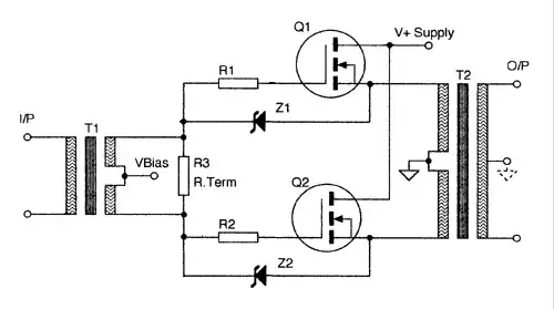

A hybrid amplifier: Transformer voltage gain & MOSFET power gain
The website of the person who designs these amplifiers, an IEE member, makes interesting reading. Their comments and terminology leave no doubt about what they think about provision of voltage gain without powering.
[Susan Parker, MIEE, Zeus Power Amplifier - A Zero Feedback Power Amplifier, for Audio and Other Applications.
Susan's Audiophonics site.
She says - "I use transformers by design as the primary building blocks and gain stages
and either tube or solid state devices as followers. This topology is further explained on this site."
Here is an interesting example of a high quality audio amplifier - one of a family - which uses transformers to provide voltage gain, and semiconductor voltage followers, with a voltage gain of less than 1, to provide power gain.
Here the actual voltage amplifier is wholly unpowered and provides the voltage gain for the whole system. The amplifier as a whole could not work with only the power amplifier or only the voltage amplifier.
Zeus Power Amplifier - note that the two MOSFETs are voltage followers with a voltage gain of less than unity.
