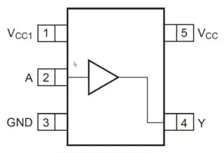

You can build a logic level shifter (that's what it's called) with a few discrete components (transistors and resistors) or you can go for a one-component solution, i.e. an IC. Most ICs won't accept input voltages as low as 1.4 V, but I found Fairchild's FXLP34 which does. (You want the FXLP34P5X, the other versions have leadless packages and are therefore more difficult to solder)
Connection diagram:
FXLP34
A is where you supply the low-level input signal, Y is your "high"-level output signal. Vcc1 is your 1.4 V connection, connect the required output voltage to Vcc (up to 3.6 V).
The device may be hard to get in low quantities, maybe a distributor can supply with a few samples.
PS: yes, that tiny cursor is also present in the image in the datasheet :-)
edit
An alternative part, in case PCB space is a premium: the OnSemi NLSV1T34 is available in a Damn Small™ 1.2mm x 1mm DFN. For mortals also in SOT-353.

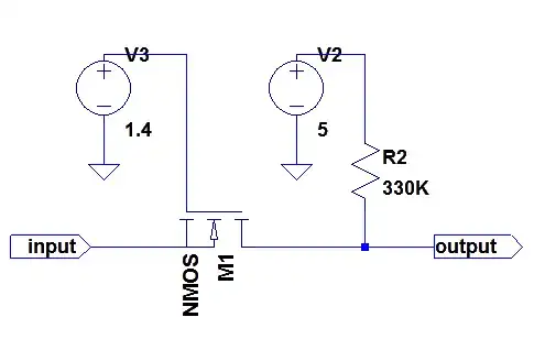

The basics of the problem as you have described it, appear to be called either a "logic level shifter" or converter. The essence is that you have a digital logic (binary) signal at a given signal level, and you wish to use adapt it to another signal level.
Digital logic signals are normally classified according to the original logic family they belong to. Examples include TTL (low: 0, high: +5V), CMOS (low: 0, high: 5 to 15V), ECL (low: -1.6, high: -0.75) , LowV (low: 0V, high: +3.3).
Ideally, you should also be aware of the switching threshold as well. E.g Logic signal voltage levels that shows the TTL logic voltage levels in the first two graphics.
If you wish to amplify a logic signal that is either 0 or 1.4V, then a single transistor can be configured as an electronic switch to act as a level converter.
N-channel MOSFET level shifter schematic (src: mctylr CC-BY-SA)
In your application the output is the 5V-level output (0 or 5V depending on low/high status) and M1 could be a common small-signal N-channel enhancement mode MOSFET transistor, the 2N7000 in TO-92 plastic through-hole, and SMT packaging.
The resistors R2 should be 330Kohms, (additional resistor component details are not critical, e.g. 1 or 5% tolerance, 1/8 to 1/4 Watts rating are fine).
The resistor's resistance values is not particularly critical, I picked an approximate standard value so that if M1 is not conducting then the output will be below ~0.8 V, while when M1 is conducting (i.e. the input is 1.4V, 'high') then the output will be approximately 5V. I picked the value using a quick SPICE simulation.
V3 is a +1.4V voltage source, and V2 is a +5V voltage source.
The other values (tolerance and wattage) are common through-hole component values used to select real-world component, but are not critical in this application.
That's a very simple and small circuit, costing about twenty-five cents or less for three common electronic parts.
Since you didn't mention any high-speed requirements (i.e. switching speed), so this should work in most simple cases.
I've adopted this approach of using a MOSFET rather than a bipolar junction transistor as I had trouble making a single BJT give the desired voltage swing when switching. From a design point of view, the nice thing about FETs (and MOSFETs) is that they are voltage controlled devices (in terms of a design model), rather than current-controlled as BJT are.

  • Thanks for the answer, it's a little too complex for me, but it's something to work towards. Where would I get out the increased signal? – Jonathan. Mar 25 '11 at 20:11
    @Jonathan - At the "Out" pin; you'll need a pullup resistor to 5V. – Kevin Vermeer Mar 25 '11 at 21:14
  • Surely I need another voltage in. Also how did you calculate the resistors' resistance? – Jonathan. Mar 25 '11 at 21:22
  • @Jonathan In such a circuit the resistor values are not very important unless you need fast signals. They should just be higher then several kOhms so that the current stays low. If you set the resistors too low you could overburden your 1.4V outputs. – jpc Mar 26 '11 at 01:57
    This also inverts the output. – freespace Mar 26 '11 at 03:30
  • @freespace, Doh! you are correct. – mctylr Mar 26 '11 at 05:25
  • This circuit is also unidirectional. That will be fine for many circuits, but for those where a line is used by both ends to communicate bidirectionally, no dice. – Warren Young Mar 26 '11 at 07:33
  • @Warren Young, yes that is correct, but based on the question that does not appear to be a factor in this case. – mctylr Mar 26 '11 at 18:28
  • @freespace, Thank you. I have replaced the NPN schematic with a non-inverting PNP transistor switch. – mctylr Mar 26 '11 at 19:10
  • @Jonathan - If four parts is too complex, I don't think you're going to have much success in electronics. – Connor Wolf Mar 27 '11 at 05:11
  • @mctylr I think you need to move the output connection so it is pulled up by the 5V line when in is high, which switches the PNP off. As it stands I believe it still inverts. – freespace Mar 27 '11 at 06:06
  • @Fake Name, no i'll just keep trying, and the answer has been edited since then (thanks btw, mctylr). I know a bit of the physics, like what happens inside a diode, but I'm wanting to know the more practical side, and it's why I want to do this myself and not buy a pre made one. – Jonathan. Mar 27 '11 at 10:24
  • @mctylr, it's still inverted, and if I switch the output and resistor to the other side of the transistor, then the logic is not inverted but the voltage is only increased by 0.4V – Jonathan. Mar 27 '11 at 12:54
  • @mctylr, pleae your answer is almost there! Then I can accept it. – Jonathan. Mar 28 '11 at 23:05
