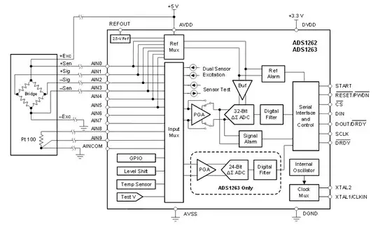

Why not turn it up to 11, and just use the TI ADS1262. It's a 32-bit ADC, with 11 inputs and a PGA!
ADS1262
With 32-bits, you can pretty much sample anything. And it's not even that expensive. What's more, if you're only making one of these, just get a free sample.
