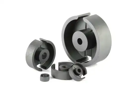

How I've made them in the past is to use pot cores Which are like inside out toroids. Here is a picture from dexter magnetics: enter image description here
You use two bobbins to wind your primary/secondary on. cast them with epoxy and then mount the two open faces close together.
