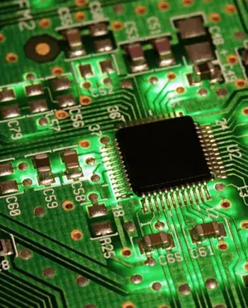

Some BGA packages force us to put capacitors on the opposite side of the board, directly underneath the chip, as described by Peter Bennett. Since I haven't yet used such high-density BGA components, I find that keeping all the surface-mount components on the same side of the board typically reduces costs.
I personally find it much easer and takes less time to
  • leave more space than I really need around TQFPs, and later squeeze everything together, rather than
  • pack components closely, and repeatedly discover that there's not enough room for the traces, so each time I nudge the components a little further apart.
There are a few cases where bigger capacitors make it easier to lay out the PCB. When a package has an I/O line, then a VCC line, then an I/O line, then a GND line, then another I/O line -- a bigger capacitor can make a "overpass bridge" from the VCC to the GND line, and the I/O line can run underneath the capacitor, something like C65 and C61 in this photo:
(image from http://veriest-v.com/index.php?id=16 )
