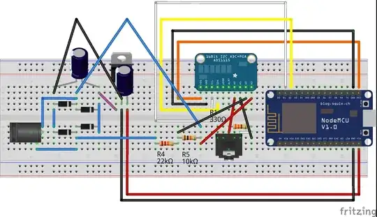

I have been working extensively building web connected Energy Monitors using the ESP8266 (with Arduino IDE) and various ADC's and dedicated Energy monitoring DSP's (ATM90E26 and ADE7763).
Fritzing diagram of basic ADC + Wifi enabled Arduino compatible NodeMCU is shown below:
Code for using ESP8266 Energy monitor illustrated above is here. Please note that this is a low-accuracy simple to implement solution sampling the voltage using a transformer and the current using a CT. Higher accuracy solutions need to sample 240V directly (using a voltage divider ladder and shunt resistor) and require additional design considerations to handle issues arising from working with high voltages.

Welcome to EE.SE! Unfortunately, this seems to be at best an indirect answer to the question, and is mostly intended to drive traffic to your websites, which is a form of spam not allowed here. – Dave Tweed May 18 '16 at 13:24
OK, you've removed the links. However, the OP seems to be asking more about the hardware side of the problem, not the software. Also, be aware that this is a 5-year-old question, and the OP never came back after asking it. – Dave Tweed May 18 '16 at 15:19
I have added schematics of a proposed solution. The hardware to do this in an easy manner did not exist 5 years ago. It does now due to proliferation of wifi capable SoC's. – whatnick May 19 '16 at 02:37
1@Dave Tweed , Who cares about the OP? The whole point of SE is to be useful to the whole community, and whatnick's post added a new way to solve the problem (even without the added schematics). – Sredni Vashtar May 19 '16 at 05:04
