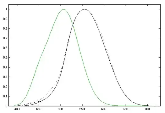

Photometric measurements define how bright a source appears to the eye. The candela (or, for LEDs, the millicandela or mcd) measures the intensity in a direction. The lumen is a measurement of power, and is defined as one candela over one steradian of area (a steradian is a cone about $64^o$ across). Both are weighted with respect to the radiometric units by the luminosity curve, which looks something like this (dotted black line):
luminosity curve
Notice that it peaks around 550nm, or the color green. What this means is that your red and blue colors need to have high wattage ratings to get even coloration. If you use the millicandella ratings (for a variety of viewing angles) or the lumen ratings (if you've already selected a set of similar viewing angles), you don't have to worry about this curve.
