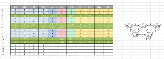

Ok, so first of all I have the state machine and the truth table I did for it in the following image:
State machine diagram and Truth Table for it

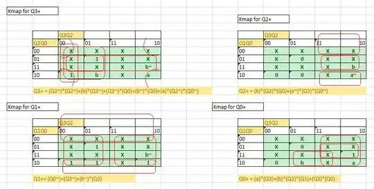

The next thing are the kmaps:
The Kmaps

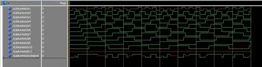

The test bench produces the following result:
test bench simulation
As you can see, the first signal has some odd behavior, the next signals work ok, and the last on is completely undefined. Of course the final signal, the output, is flawed.

    Very good question presentation. While Modelsim may allow `18ns` it's specifically illegal in the VHDL standard and will remain so. There are two separate lexical elements abstract literal `18` and identifier `ns`. See IEEE Std 1076-2008 15.3 Lexical elements, separators and delimiters, para. 4 - "... . At least one separator is required between an identifier or an abstract literal and an adjacent identifier or abstract literal". You could have written your stimulus as one process using incremental time in wait statements. It may have pointed to the undriven signal directly. –  Jul 03 '14 at 23:06
  • Can you please elaborate on the stimulus part? I think what you said is something I've also searched a lot but found nothing: the warnings my every test bench produce. Do you mean I should type a space between **18** and **ns**? _edit_ Verified, that was the problem. – Azurium Jul 03 '14 at 23:33

There are two easy ways for a signal to be corrupted:
  • drive it from several signal sources
  • don't drive it from any
Now A11 remains 'U' throughout, suggesting it has no driver. While A1 alternates between valid and 'X' invalid values, suggesting it has more than one driver.
With that in mind, review your code where you drive A1 and A11.
You'll laugh...
To expand on the "how to debug" part of the question : having aroused a suspicion that signals were not driven from the expected sources, you could use Modelsim's "drivers" command to list the drivers on a signal. If you had written slightly more verbose VHDL, and labelled each process, that would get you the same answer without having to review your code...
