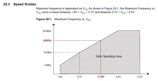

It looks like you're running the MCU outside the safe operating area with a coin cell. According to the ATmega328P datasheet, page 316, the minimum safe supply voltage for 16MHz is around 3.8V (the red markings are mine). You should expect to see erratic behavior in that case. In practice, you're just overclocking your MCU. See what Russell McMahon has to say about this.
ATmega328P safe operating area

  • Thank you for the info. I did realize it was out of spec for this test but the results appeared to have a pattern unlike the values that I usually get when I lower the voltages further down and force a brown-out. So was trying to figure out if it tries to switch down and operate @ 8 MHz before it throws in the towel. – user46743 Jul 03 '14 at 18:56
  • Right. As Russel says mockingly in his post (which I linked), by going past the specs, you'll be venturing in unknown territory. As you test the MCU limits, things may seem to work, but you may get erratic behavior when you least expect. By the way, I hope you didn't take offense me linking to Russel's answer, as it's a bit too humorous - but it does illustrate my point well. – Ricardo Jul 03 '14 at 19:19
  • But no, the ATmega won't change its clock. It would be useful if it did, but it just gives up in unexpected ways. – Ricardo Jul 03 '14 at 19:20
  • Thanks for the link. No offense, not at all. Concise and clear explanation. The link was pretty funny and informative, as well. I just wish stackexchange had a feature to mark more than one solution as an acceptable answer. – user46743 Jul 03 '14 at 19:23
  • No sweat. Mark whatever answer you find most useful **to you**. Other's may vote differently, but accepting the answer is your choice :D – Ricardo Jul 03 '14 at 19:26
