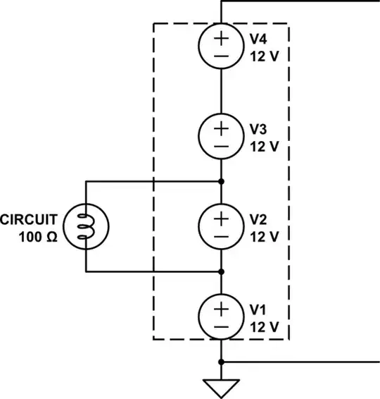

For powering your circuit you may look into the possibility to tap into the series-connected array. Usually individual panels have voltages much below the final system voltage, e.g. 12 or 36V. If you connect your circuit to only one panel you may have the power supply problem solved:
Where "CIRCUIT" would be your circuit/power supply while the dashed box represents the whole array of panels (four in this case).
Measuring 5A should not be hard to do either, but someone else will have to hint you at viable solutions to safely measure those 600V.
Disclaimer: Your project is potentially dangerous to you or your environment. What I said above is my personal opinion and may be completely wrong. Proceed at your own risk, but do so very carefully.

  • Thanks Hanno, sorry but I do not have the option to use a single panel for this. But I agree that would be a simple safe solution – Enrico Jul 03 '14 at 12:57
  • Another note: Have a look at the specs of the panel array. It may well have a *nominal* (MPP) voltage of 600V but a low-/no-load/idle voltage that's significantly higher. A 12V-nominal panel may well yield 18V with no load, which, extrapolated, would be 900V max on your array, and your circuit would have to deal with that too. – JimmyB Jul 03 '14 at 15:22
  • Yes you are right, the 600V is based on the open circuit voltages of the panels, so the absolute maximum without any load. I just have no access in this situation to separate modules, it is no option. Otherwise it would be simple... – Enrico Jul 03 '14 at 20:13
