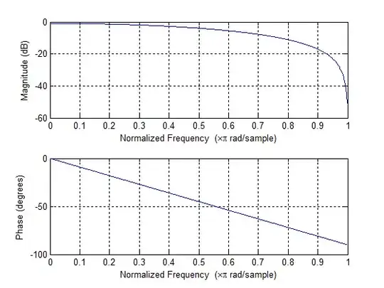

The key at this point is to remove all noise and determine the time delay between when you transmitted and where your current signal is at. Just like the comm systems, this delay can be viewed as a phase shift. Because of this you want your filter to have a linear phase response otherwise you wouldn't be able to tell (at least not easily) what delay your signal actually had. Here is an example of the frequency response of an FIR filter I just made:
FIR
As I am sure you can see, the phase graph is a straight line, so it is linear.

The phase graph isn't so linear this time. Now it is possible to reverse this phase effect in your delay time calculations, but it usually isn't worth the effort, instead people just use an FIR filter.

  • @AngZhiPing, the important part from his graph is the linear phase corresponds to a **flat* group delay, the same delay for each frequency. Linear phase filter corresponds to a symmetric filter in the time domain impulse response which is not physically possible with an IIR filter as you would need an anti-causal system. – Kortuk Mar 23 '11 at 01:01
  • Though I understand group delay, would be good if you can add on the corresponding group delay graphs for added clarity. – Ang Zhi Ping Mar 24 '11 at 01:21
