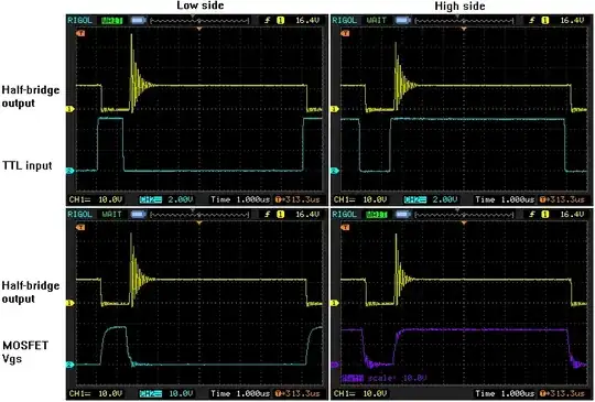

Upon testing the circuit with a load I found out that while the low side switches quite cleanly there is a lot of ringing at the output of the half-bridge (X1-2) every time the high side switches on. Playing around with the input waveform dead time setting and even removing the load (an inductor with a power resistor in series simulating a synchronous buck converter connected from X1-2 to X1-3) did not reduce this ringing. The measurements below were taken with no load connected (nothing at X1-2 except for the oscilloscope probe).
Ringing
Apparently the parasitic inductances and capacitances are enough to cause that, but I cannot figure out why the low side works as well as it does. To me both gate drive waveforms look clean enough, with the voltages transitioning the treshold voltage of the MOSFETs reasonably fast. No shoot trough is present when switching. What are the possible causes of the problem, and what measures can I take to reduce the symptoms?

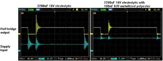

While there was a 2200uF electrolytic capacitor at the input (X1-1 to X1-3) to supress transients and noise, it clearly failed to supress any high frequencies. Adding a 100nF capacitor (as suggested in the answer by Andy aka) in parallel with the electrolytic one reduced the ringing at the output (X1-2 to ground) by half and ringing at the supply (X1-1 to ground) by a factor of 10.

Try probing on the power supply rail. I bet you see those spikes on there. It'll be due to the lead length between your bench supply and the MOSFETs. Clearly you won't see it on the lower FET side because your scope is referenced to that rail but, if you probed back at the power supply I bet you would.
Try a 1uF or 10uF ceramic across the power rails close the MOSFETs.
    +1 There are harder ways to learn this, ones that might lead to little piles of smoked MOSFETs. – Spehro Pefhany Jul 01 '14 at 17:02
  • A 100nF metallized polyester cap reduced the spikes dramatically, but not competely. Are ceramic capacitors better suited as bypass caps in applications like this? I sadly have no high value ceramics in my parts box. – jms Jul 01 '14 at 17:16
    What you might be seeing now are possibly o-scope artefacts. Try connecting the scope directly across the cap with as short an earth lead loop as possible. Induction into the loop is commonly found. You should be OK with that cap. How big are the spikes now? – Andy aka Jul 01 '14 at 17:59
  • At the frequencies you're seeing, yes, a ceramic will be better than polyester. – WhatRoughBeast Jul 01 '14 at 18:34
  • @Andyaka With the probe connected directly to the 100nF cap it does not matter anymore which FET switches, the ringing at the output (X1-2) [is the same](http://i.imgur.com/XCx00oY.png), and the ripple at the supply (X1-1 to X1-3) is reduced to two volts. Any suggestions on how to further attenuate the 20MHz spikes at the output? Is the board layout to blame? – jms Jul 01 '14 at 19:10
  • I don't know - I'd have to physically have the board in front of me and do some probing around. – Andy aka Jul 01 '14 at 19:24
  • @Andyaka , You suggest 1uF or 10uF ceramic cap. Is there any type in particular that you would recommend ? I mean in terms of package: SMD or through hole, and I should only consider the max voltage in power lines to select de voltage of the caps? And Film caps? .. for this values are more cheap than ceramic – Gabriel Rezende Germanovix Dec 15 '15 at 16:15
  • Ceramic surface mount are the preferred option. – Andy aka Dec 15 '15 at 17:48
