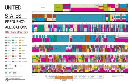

The bandwidth of the Wifi signal is nothing like 2.4GHz-it's 20 or 40MHZ.
What you are suggesting (baseband 2.4GHz) would use up the entire EM spectrum to 2.4GHz for a single channel of communication.
As you can see from this, it's already pretty well used for various other things:
Essentially, the 2.4GHz carrier is wobbled a little bit to send data and that allows many channels to be simultaneously transmitted while still leaving plenty of spectrum for other applications such as key fob remotes, AM/FM radio, transponders on ships and aircraft, and so on.
