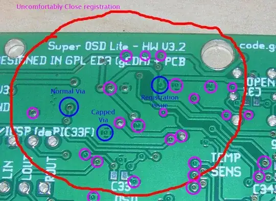

As in the title. I've noticed several PCBs of mine have vias which are not plated - they do not have a characteristic "gold" shine to them. I suspect this is because I was pushing the limits of drill sizes - my fab specifies 12 mil and I used 15 mil (20 mil including plating.) I've checked a few with a multimeter and they do have continuity, which is good, but I've only checked a few, so have no idea if there might be a few dodgy connections because of this. Is it something to be concerned about? Board passes DRC as specified by fab.

Here's an older board of mine which shows a similar problem to my newer boards. Note that some vias look gold, while others don't look plated at all.

    Wait - Your fab can do 12 mil vias, but you used 15 mil? That should be *easier*. Also, can you upload a picture? If the holes aren't plated through, you won't have continuity. Are you saying that they're missing an annular ring? Confused... – Kevin Vermeer Mar 19 '11 at 22:10
  • @reemrevnivek. I'll upload a pic later, my camera sucks for macro. I think the problem is the lack of annual ring on both sides of the board - the vias look otherwise identical to any other copper. – Thomas O Mar 19 '11 at 22:32
    It's a bad picture, but it looks to me like you've accidentally tented your Vias. Check your gerbers, I bet your solder mask layer covers the vias. Your boards are fine. – Zuph Mar 21 '11 at 01:31
  • @Zuph, if the etch mask registration is bad enough (looks borderline in the picture) and not covering the via entirely, the enchant can work its way into the via and eat it out. – Nick T Mar 21 '11 at 05:31

You definitely have some really hairy registration issues on the board you posted pics of. It may work, but you're really pushing it.
Generally, you never want the via hole to break out through the edge of the annular ring, which is happening a few times in the picture you posted.

Anyways, I think the reason you are finding your vias a bit odd looking is that you have tented your vias, which is the practice of covering the annular ring and the hole for the via with soldermask.
With 0.015" vias, you will occasionally get a contiguous layer of soldermask over the hole, and they will look different.

  • It was only $40 for 10 boards. Registration error specified as 0.09mm. http://www.seeedstudio.com/depot/fusion-pcb-2-layer-10cm10cm-max-10pcs-p-396.html?cPath=185 – Thomas O Mar 21 '11 at 07:51
    Self-evidently, it sounds like the chinese PCB house is fudging their numbers. – Connor Wolf Mar 21 '11 at 08:26
  • Yes, it appears that every hole is plated correctly. They tented some vias (completely covered and filled the hole with green soldermask), which is also fine -- the metal *is* shiny under the soldermask. Go ahead and put parts on the board -- the mis-registration appears to be (just barely) small enough not to hurt anything, so it will probably work fine. – davidcary Mar 22 '11 at 17:58
  • Interesting that a new board I got is fine. Almost zero registration error. And I used smaller vias @ 14 mil. – Thomas O Mar 28 '11 at 22:35
  • I've discovered how to get rid of my tented vias in gEDA/PCB, using ctrl-k, which is good, so I'll see if my latest boards are any better. – Thomas O Mar 28 '11 at 23:00
  • Registration will vary on a per-panel basis, since it is determined by the unmounting of the board from one machine, and remounting in another. Basically, there is some variability in the precision, and the fab house should specify their worst-case error. Some production runs will indeed be fine. – Connor Wolf Apr 26 '11 at 06:15
