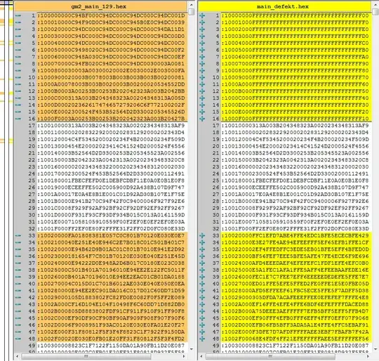

This is a comparison of the original flash contents (left) to the corrupted contents (right):
Flash comparison
Some observations:
  • A corrupted block always consists of at least one flash page (256 bytes) and is page aligned. In other words: Only whole pages are affected, not single bytes.
  • Corrupted content reads 0xFF most of the time, but may also contain some other values or be completely "random".
  • The small bar on the left side of the image shows all affected areas. For this device, its about one tenth of the total flash contents.
  • We had one device where only a single page was affected.

  • In the second block in your example, did any bits go from 1->0 or all they all 0->1 transitions? I have a script that computes this, but I'm not going to type in all the numbers from your screenshot. – markrages Jun 25 '14 at 15:55
  • @markrages: From looking at it, 0->1 only. One answer also pointed out, that it looks like a partial erase where not all bits were flipped to 1. Thanks for the observation. – Rev Jun 25 '14 at 19:38
You should notice that the flash is not written, it is erased. An erased flash is full of 0xFF. Your first 256 bytes are totally erased, your third 256-bytes region is partially erased (you only have 0 to 1 bitflips from correct data to corrupted one).

  • Your observation about the partial erase on the third page seems plausible. Regarding the Atmel text: We all agree that BOD seems to be mandatory. But I am still not sure about the EXACT cause of the corruption. Isn't it pretty unlikely that the controller just executes (because of low-voltage) this specific instruction to erase a flash page? I mean, this would even have to happen during boot loader code execution, since flash is only writable from there. And it requires a specific sequence. – Rev Jun 25 '14 at 19:30
    It's not possible to explain the exact source of the corruption : as your Vcc drops, it becomes too low to fully saturate one transistor with an other one. A MCU is basically a very big logical equation. If your transistors stop behaving as logical switches, you change this equation. As the first transistor to misbehave depends on ASIC Wafer doping and external electromagnetic perturbations, you can't predict what will happen. To address this issue, when you design your ASIC, you may add an analog part that switch off digital part before misbehaving. But it increase the whole ASIC cost. – Jacen Jun 26 '14 at 11:35
