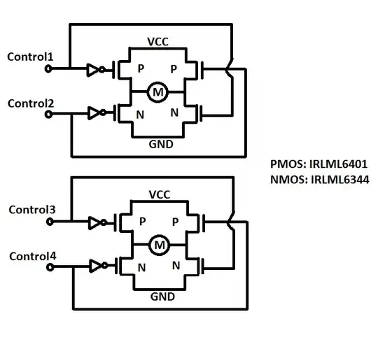

  • @EM Fields: I only have 6 I/O's available to control 2 motors (2 full bridges). that is why i only used the 4 pins instead of 8 to control 2 motors. – Electronics_Guy Jun 22 '14 at 18:13
  • @EM Fields: If i used a MUX to expand the number of pins to control the transistor gates individually would it work? – Electronics_Guy Jun 23 '14 at 09:22
  • It may. I'll work on it and post something in a while. – EM Fields Jun 23 '14 at 13:03
  • @ EM Fields: Could you check the diagram on the bottom? The one with separate controls (Control1, 2, 3 and 4). – Electronics_Guy Jun 30 '14 at 07:09

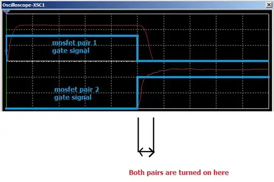

You have to understand few important things in bridges like this.
  1. Mosfet has some turn-on and turn-off time - delay after gate signal is off.**
You have to add some delay between you turning off first pair of transistors and turning on another.
Sorry for bad quality drawing. This is supposed to show you what happends if you turn on 2 mosfet pairs are turned on.
By pairs - I mean
  • first pair: top-left and bottom-right
  • second pair: - bottom-left and top-right
2. Your bridge needs "logic-level" mosfet that can be fully opened with 3.3V (thats very low voltage). This is Vgs (gate-source voltage) transistor parameter. On your schematic - it looks like you have 3.3V microcontroller. If you so your gate voltages is 3.3V. It can be as low as 3.0V when LiPo battery is discharged and under load.
Transistors in applications like this should be fully open or fully closed to work efficient, otherwise they have significant resistance, and there are big power losses on that resistance. That power loss on resistance can damage transistor.
Modern mosfets, when they are fully opened have very low resistance (under 1 ohm), thats why they can be used for switching relatively high currents even without heatsinks.

What about this circuit using NOT's and crossed complementary PMOS/NMOS? Would you say something like this work?
The NOT will give a considerable delay to the NMOS i think.
That'll work, and you'll save 2 I/Os and you'll be able to run both motors at the same time :-), but you'll have to be careful; see the red stuff following...
Also, the inverter (NOT) will only add a slight delay through the conducting pair, but will do nothing to prevent shoot-through while the bridge is switching; that must be done by judicious software design.
Take a look at the MOSFET data sheets for their gate capacitances and their ON and OFF switching times for an idea of what must done in terms of delays.
Also, following are the edited schematics annotated with MOSFET reference designators and truth tables.
