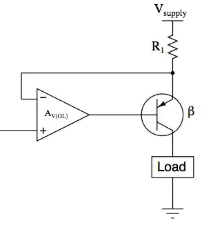

If the changes in sensor resistance are large (> 50%) then you could use a voltage divider circuit instead of the (more complicated) Wheatstone bridge. You can then easily improve the dynamic range by varying the supply voltage.
Adjustable supply voltage can easily be made from the PWM in your microcontroller together with a RC filter and a voltage-controlled current source.
Here is a rough schematic of my idea:
Schematic(from Socratic Electronics by Tony R. Kuphaldt)
You then connect the filtered PWM voltage to the non-inverting (+) input of the op amp.
For fast multiplexing you could make two such current sources. If you connect all even sensors to one and all odd to the other then you can change the voltage on the next sensor while your ADC is still sampling.
You should use a precision voltage reference for the ADC. You can also gain 1 or 2 bits by using a moving average filter in your software.
PS. I'd like to thank Jaroslav Cmunt for his vast improvements to this answer.
