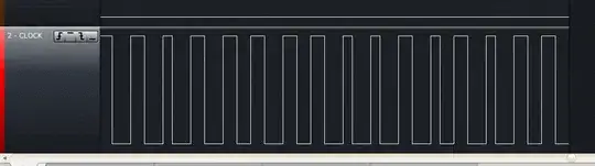

I noticed that on Raspberry Pi, SPI Clock generates steady 50% duty cycle. On my OMAP4 boards, it varies between 2 or 3 values. The values in the screenshots are: 33.3%, 42.9%, 40.0%, and 42.9%. My logic analyzer is measuring at 16MHz, while the SPI clock run a little over 2MHz.
I am simply sending random text like below:
echo "HELLO!!" > /dev/spidev1.0
This is the screenshot of my OMAP4 clocks
I am very puzzled because I think this might be causing buffer overflow and underruns - eventually getting CRC16 failure on the receiving end.

19
You see aliasing in your capture, not clock jitter - a case of the wrong tool for the job.
A 2Mhz clock has a 500ns period, so is high for 250ns. With a 16Mhz logic analyser you are taking samples every 62.5ns, so ideally you'd see 4 high samples, 4 low samples repeating.
Now consider the effect of a minuscule 0.5% difference in frequency on the CPU oscillator, so the divider network down to the SPI bus now runs with a 251.25ns period. Note: the frequency doesn't drift over time, it's still an ideal crystal, but the waveform we're trying to capture is no longer an exact multiple of the capture clock 62.5ns. This gives you aliasing with patterns of 4/4, 3/5, 4/4, 5/3,... as the hi/low ratio in your capture as you observe the phase relationship between the two clocks drifting in and out.
Your analyser is still good for capturing the SPI signals (above Nyquist etc), but it is not suitable to judge clock stability. For that, use a scope triggered on one edge to see the stability of the other edge and a calibrated frequency counter to check the absolute frequency.

  • I did the same on RPi, and I get really good 50/50 split. It was the same 2MHz clock. So I don't think my analyser is aliasing the signals. – Adam Lee Jun 17 '14 at 20:08
    @b1gtuna - You're missing the point, which is very *small* variations in the clock frequency (0.5%) can cause this kind of aliasing. That kind of variation is very common in things like this. I expect if you sampled the rPi for long enough, you see the same behaviour. – Connor Wolf Jun 18 '14 at 00:05
    @b1gtuna - I think Connor is right, this looks like aliasing to me. A logic analyzer is not designed to sample a clock, it is designed to sample ON a clock edge. You should use a scope instead. – Mark Lakata Jun 18 '14 at 07:18
    The closer the frequencies are to an exact multiple the more output you need to view to see a non 4/4 sample - mismatches occur at the [beat frequency](http://en.wikipedia.org/wiki/Beat_(acoustics)) between the two clocks. – shuckc Jun 18 '14 at 15:20
    Another vote for aliasing from me. I've seen the same thing happen and increasing the sample rate has cleaned it up. – dext0rb Jun 18 '14 at 15:21
  • Ah, I slept on the answer and now it makes a lot of sense. The other day I didn't really get a chance to digest it. I am voting this as the answer - as aliasing is what seems to be happening. Thank you all for the help! – Adam Lee Jun 18 '14 at 16:46
