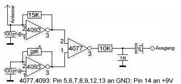

Linearizing the pitch sensitivity - I found that the upper octave was much compressed and that the highest notes I wanted to play were so close to the antenna that accurate vibrato wasn't possible. A way to linearize the response is to put an inductor in series with the antenna.
http://www.dogstar.dantimax.dk/theremin/thersens.htm
This effect is partially offset by the nature of the LC tuned circuit, the frequency of which depends on the inverse square-root of capacitance. This is the main reason, I believe, why oscillators based on a single pole (only one reactive component, i.e. capacitance) never took hold for theremin use. I, and probably many others, have experimented with RC oscillators in an effort to get rid of those pesky coils; even the ordinary NE555 timer can be used for this purpose. However, in such circuits the oscillating frequency is inversely proportional to capacitance, rather than square-root of capacitance, and the "square-law" effect is correspondingly a lot worse. Another way of looking at this is that sensitivity (dF/dC) of the RC circuits is proportional to 1/C2 instead of 1/C1.5 in the case of the LC circuit.
