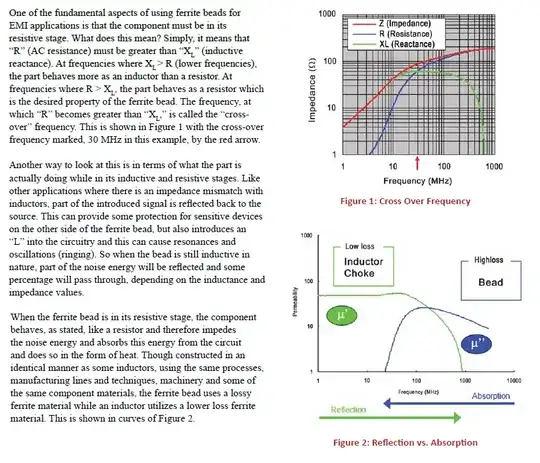

I would urge you to read this document. Some of the salient points I have noted below: -
Summary - probably best not to use ferrite beads because they only really start to come into their own above 30 MHz.
Basically I think some of the problems you might be trying to solve are best left in the "inductor" arena whilst maybe the 10MHz sq wave (and more importantly its harmonics) may be dealt with by using ferrite beads.
However, my advise generally is - use ground planes followed by very good capacitor decoupling on all chip power supplies and if you can use small resistors feeding power to vulnerable places (maybe 1 ohm to 10 ohm). If this doesn't prove successful I would want to know why and possibly improve grounding and decoupling before inserting inductors and certainly before considering ferrite beads.

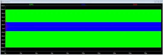

I'm not a filter expert, but the circuit on the right forms a pi type filter. I ran a simulation with LT Spice IV (it's free!) investigating these two configurations for something I'm working on. The circuit on the right works about as well as the circuit on the left from what i can tell. be advised i did not use your exact circuit values. These arrangements attenuate well (red waveform). The green waveform is +/- 100 mV square wave @ 25 MHz. My inductor: 600 ohms at 100 MHz (1.9 uH), caps are .1uF and .01uF. There is slightly better performance when the larger cap is placed closest to the noise source. If you move the ferrite bead so that is closest to the load, it yields the worst performance, but does attenuate (blue waveform).
