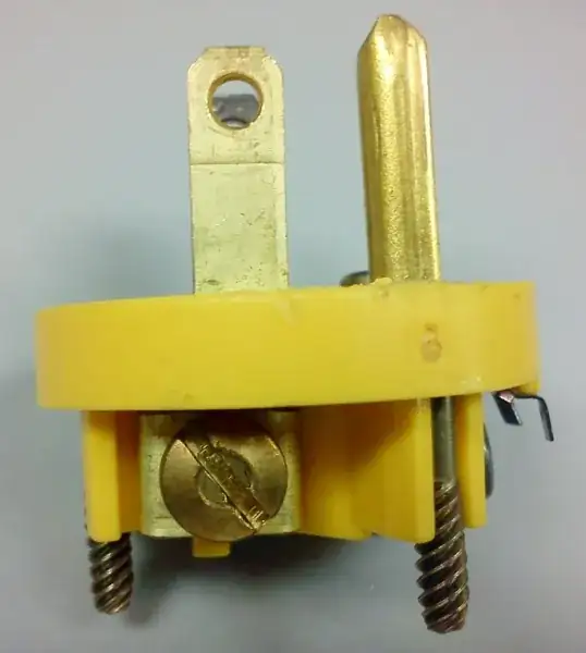

Why do most NEMA 5-15P (North America 125V 15A) line and neutral blades have holes in them? I've been wondering this for quite some time and haven't yet found a satisfactory answer.

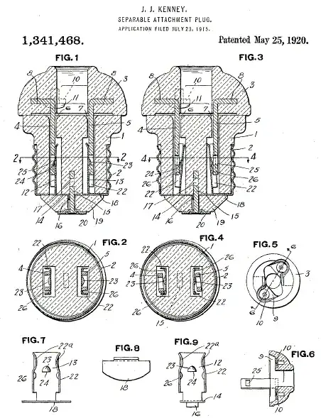

Almost a century ago, back in 1915, John J. Kenney filed his idea of an electrical connection system and connectors that "prevent accidental separation" for a patent that was granted to him on 25 May 1920: US patent 1341468.
1341468
A small quote: "When the terminals (4) and (5) reach final position these projections spring into openings (25) in said terminals and positively lock the cap and shell and prevent accidental separation thereof."
Another slightly younger 14 September 1920 US patent 1352817 shows the holes without extensive comment/description: as if they were already routine by that date.
1352817
Even relevant modern day patents like Mark Kenny's US Patent 6595810 from 2003 still reference this John J. Kenney patent and clearly state it's use.
As Cubiclegnome & Olin Lathrop already said: there were even physical locks in production, besides the known "out-dents" on the "blade-engaging members" in the receptacles.
I think this 'origin' out-dates ANSI/NEMA WD 6-2002 regulation, that also had to regulate what was already in large scale use.
Just like the wide-spread use of non-fixed lightning armatures (like desk-lamps and such) and house-hold appliances like boilers (whose chassis was 'grounded' to 'neutral' instead of 'earth', which was actually legal North America until 1996!!) lead to the (invention and eventually mandatory) use of polarized wall-outlets.
But who knows, there might even be an older origin/patent (but I can't find any reference to it).

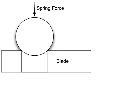

I have seen those holes used to retain the plug in the socket. Imagine a spring loaded ball that nestles into the hole when the plug is inserted. The ball is larger than the hole and when engaged with the holes on the blades provide a retention force. In picture blade is removed by pulling to the right. enter image description here

  • The holes keep the blade from slipping out of alignment when some stress is applied on the crimp attached cord to keep it straight when the rubber molding is applied. – Skaperen Oct 26 '12 at 03:39
  • My pictured plug has mechanical 'vise' style wire connects (turning the screws tightens the grip on the wire) and I'm pretty sure there's no jig available to hold the blades via the holes. – Adam Lawrence Oct 26 '12 at 12:10
