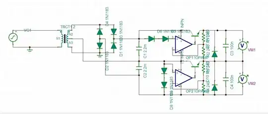

Here is my circuit using my simulator of choice: Texas Instruments 2016 release (it's only release) of the incredibly easy to use and simulate TINA (plus it's smorgasbord of TI parts already in its component select menu and multitude of examples. They don't have the LM337/LM317 in there though so I used Op-Amps with a single pass transistor output stage with two Diodes on their Non-Inverting inputs to represent the Band-Gap Voltage Reference.
enter image description here EDIT: I wrote this while walking and using Voice2Text so I corrected the errors my phone made
LOOK-UP TABLE TO BE USED WHEN RECTIFYING AC VOLTAGE TO 25-VOLTS IN THIS CASE. IF YOUR DESIRED VDC IS 12 THEN DEVIDE THE NUMBERS IN THE FOURTH COLUMN BY 25 THEN MULTIPLY BY THEM 12. DISREGARD THE LAST THREE COULMNS ON RIGHT AS THEY ARE SIMPLY THE RATE OF CHANGE OF THE VAC IF YOU WANT TO DO INDUCTANCE OR CAPACITANCE FIELD EQUATIONS. THIS ASSUMED A MAINS FREQUENCY OF 50Hz RECTIFIED TO 100Hz: enter image description here
