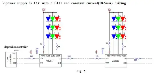

The datasheet for the WS2811 is where you need to look.
It is a constant-current three-channel driver that operates on 4.5 ~ 5.5 V, with absolute maximum ratings of 6 ~ 7 V. The output voltage is specified as 12 V maximum. Output current is maintained at 18.5 mA on each of the three output channels.
Therefore, the maximum number of LEDs you can drive with one output is dependent on the voltage drop of the LEDs. The total voltage drop across all LEDs would need to be less than the max output voltage.
Consider page 5 of the datasheet:
WS2811 5V Example
Here, using 5V, only one LED is being used per channel.
WS2811 12V Example
In this example, three LEDs are being driven per channel at 12V.
Simply put, you could drive as many LEDs as you like, provided you don't exceed 12V or require more than 18.5 mA. LEDs in series will sum forward voltages, while LEDs in parallel will share current.
Say you found an LED with a 2.4 \$V_F\$ and was satisfactorily bright at 10 mA. In theory you could connect ten of them in series-parallel (two parallel sets of five in series). The total \$V_F\$ would be 12, and each series set would receive half the current (9.25 mA).
To drive LEDs that in total exceed this driver's capability, would require additional components like transistors. Depending on your intended application, it might be more appropriate to use additional drivers and duplicate the data line to them. I have successfully driven four lines of drivers at once with the same data source, but there are a number of factors to take into consideration when doing this (slew rate, distance, etc.).

  • Thank you. I saw the data sheet but that particular page was not on there (or it did not render in my browser!). So as long as I do not exceed the volts and amperage, I could use more than just 3 for each color. – DMilton2004 Jun 13 '14 at 03:23
