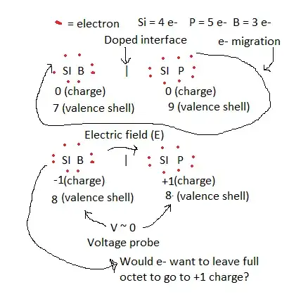

Allow me to make several unsubstantiated assumptions that might or might not be correct (this is my disclaimer).
I think this problem is a lot easier to think of from a chemistry point of view (see the picture below). Just some background information about how I think of a p/n junction and the standing electric field that is created. A molecule has electrons & protons & when these are not equal there is an overall charge. Molecules generally like to have 8 electrons in their valence shells (for atoms of lower atomic weight) which is discussed here. Since Si-P (common n-type material) has 9 total shared e- it is not at its lowest energy level (most stable configuration). Since Si-B (p-type) has 7 shared e- it is not at its lowest energy level either. So, Si-P transfers 1 e- to Si-B (creating an electric potential in the process) and everyone is happy. Other Si-P molecules can continue transferring e- to other Si-B molecules until the E field opposing their transfer gets too big.
Your question as I understand it is: why or why not is there a potential & voltage drop?
More of my background understanding: voltage is just a measure of how much e- wants to go from one place to another.
My answer (with a question): why would e- want to leave a full valence shell thus recreating 2 molecules with unstable valence shells? Yes it is true that e- wants to go to molecules with positive charges but my totally unfounded belief is that the desire to remain in a stable molecule is a stronger force than the desire to go to a positively charged molecule.
Since no e- wants to flow, no external voltage is created. I believe the reason you could still say that it has a potential is due to the standing electric field that is created across the juction boundary (depletion region).
pn junc drawing
On a mostly unrelated side note, the way solar cells create an external voltage is that the sun rays dislodge e- around the doped interface and the e- is swept across the boundary by the standing E field. Since there are an excess of e- in the Si-P region now, if you connect a wire between the 2 sides, the e- would really like to flow back towards the Si-B region (that is now positively charged since its e- was previously swept across the interface).
Hope it helps, I welcome any criticism/correction of my explanation.
