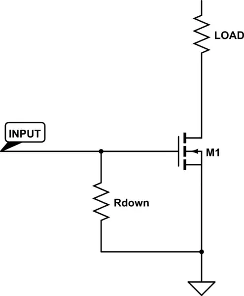

The answer depends on what you want the "default" configuration to be. For example, say you have a down-stream N-channel MOSFET, and you want it default off. Then you would use a pull-down resistor to ensure this behavior if the input becomes high impedance.
On the other hand, suppose you have an upstream P-channel MOSFET, and want it default off. This time a pull up resistor is required to create this behavior.
simulate this circuit
There's also the alternative case where you want a device to be default-on, in which case the above two cases would be reversed (pull-up for the N-channel MOSFET, pull-down for the P-channel MOSFET).
