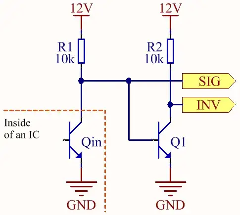

I have an IC which outputs pulses over an open collector pin. I need both these pulses and their inverses in my circuit. I want to do the inversion by using as few as possible transistors and without using any ICs.
First, I tried simply inverting the signal by a single BJT as seen below. But this won't work. Because, when Qin is on, SIG will be low, and when Qin is off, again SIG will be low since this time base of Q1 will ground the signal. The signal will be lost in any case. Connecting a resistor to the base of Q1 may seem to be a solution, but this way, the signal will be attenuated by this resistor network (it will be less than 12V).

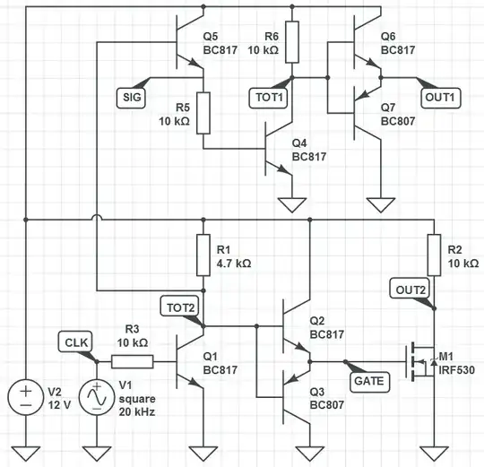

I rebuilt up my circuit according to both Brian's and Vladimir's suggestions. I implemented two methods in one circuit. Then I simulated them. Here is the schematic:

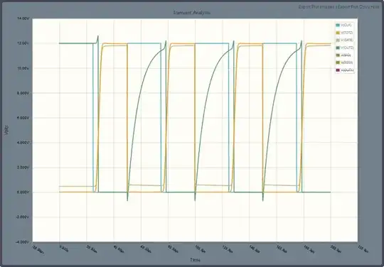

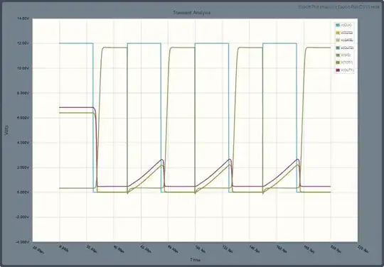

Results of Brian's circuit:
(Results are almost similar without the totem pole stage.)
Results of Viladimir's circuit:
(Results are much more terrible without the totem pole stage.)
I'm loosing my hopes on obtaining crystal clear signals. It is only 20kHz and I'm having this much of troubles. Maybe I should give up my stubbornness and use a logic gate IC.
EDIT 2:
After Viladimir's comment about IRF530 being a wrong choice of MOSFET, I started to try out different transistor types. I got a very good result when I changed Q1 with 2N2222 and M1 with BSS138. The new and better signal timings are in the image below. And these timings are without a totem pole drive; I removed it; it doesn't make a difference now.
However, this was just a simulation. Will I get the same (or similar at least) results in the real life? If yes, what was the problem with Q1 and M1? What features of 2N2222 and BSS138 made this circuit run better? I will be glad if someone makes a short comment on this.

  • I think that's because the IRF530 is not suited for this application... – Vladimir Cravero Jun 03 '14 at 19:32
  • Regarding your updated question: I haven't looked at it in any level of detail, but my first guess looking at the data sheets is that the high input capacitance of the IRF530 was your main problem (670pF versus 27pF for a BSS138). – Jules Jun 04 '14 at 00:48
  • @Jule If 670pF was the problem, then how do they drive power mosfets with 28nF gate capacitance at 500kHz with a similar totem pole ([link](http://forums.parallax.com/attachment.php?attachmentid=81424&d=1306124406))? – hkBattousai Jun 04 '14 at 04:44

Your first circuit was almost there. The problem was your analysis.
When Qin is on, yes, SIG is low. This means INV is high. When Qin is off, the base emitter junction of Q1 is held low, but INV is low.
What you need is a resistor between SIG and the base of Q1. As you point out, doing this will attenuate the value of SIG, but this is not a problem. Replace R1 with 1 k, and put a 100k resistor from SIG to the base of Q1 (and, just to be safe, another 100 k from the base of Q1 to ground. SIG will be reduced by 1%. Is that really a problem? Otherwise, the circuit will work just fine.
