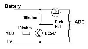

You could use a P channel MOSFET for connecting the battery to a lower resistance potential divider but it would need a spare GPIO line: -
The TPS1110 has a leakage current less than 100 nA so it won't draw too much from the battery.
  • Can't really modify the circuit, it's already built. I'm just trying to compensate for the current leakage in the code and I'm concerned that it's not constant. – Chris May 30 '14 at 17:19

Suggest you put a buffer amplifier in there or switch the divider as Andy suggested in order to reduce the impedance seen at the ADC input to 10K or less.
If you are powering the micro directly from the battery, a modification of Andy's suggestion would be to wire the lower resistor of the divider to an unused port pin rather than ground. Float the pin to turn the divider off, bring it low to turn the divider on. Then you could use a couple of 20.0K resistors for the divider and meet the 10K input spec. You can see from 28.1.8 that the pin will pull it pretty close to ground typically (not as good as a discrete MOSFET, but there you go).
