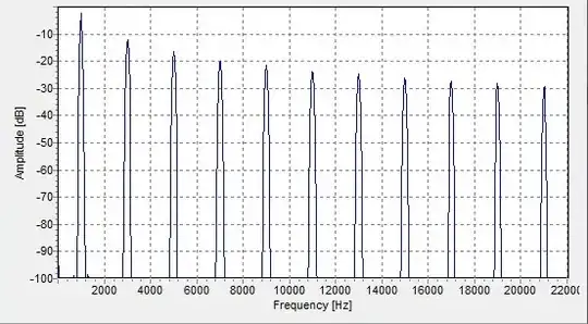

What about your square wave? Let's have a look at the plot of a square wave frequency components (also called spectrum):
(source: wikipedia)
That's a 1kHz square wave: as you can see the function plotted is very high at 1kHz, but also at 3, 5 and so on... And (trust me) the height of the peaks goes down as 1/f, that's slow. And please note I did not made any assumption on whether the wave is going or not below zero.
So your square wave is far, far away from being DC.
