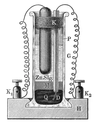

  • Weston cell - constant voltage reference: The original design was a saturated cadmium cell producing a convenient 1.018638 Volt reference and had the advantage of having a lower temperature coefficient than the previously used Clark cell. The temperature coefficient can be reduced by shifting to an unsaturated design, the predominant type today. However, an unsaturated cell's output decreases by some 80 microvolts per year, which is compensated by periodic calibration against a saturated cell.
Wikipedia - Clark Cell
  • The Clark cell, invented by English engineer Josiah Latimer Clark in 1873, is a wet-chemical cell (colloquially: battery) that produces a highly stable voltage. In 1893, the output of the Clark cell at 15 C was defined by the International Electrical Congress as 1.434 volts, and this definition became law in the United States in 1894. This definition was later supplanted by one based on the Weston cell.1
