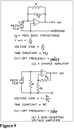

Signal Conditioning Piezoelectric Sensors from TI shows a circuit with 10 MΩ input impedance, for instance. Interfacing Piezo Film to Electronics suggests 22 MΩ and shows the most basic circuit you could use: one of these big resistors in parallel with a unity-gain buffer op-amp. If that level is too low, add two resistors and make it into a non-inverting voltage amplifier (figure 9 b):
a charge amplifier and non-inverting voltage amplifier for piezo applications
The major advantage of a charge amplifier, therefore, can be found when a long cable is used between a piezo film sensor and electronics. In addition, it also minimizes charge leakage through the stray capacitance around the sensor. Otherwise, simple voltage amplifiers are sufficient for most applications.
