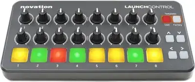

I have worked on many electronic DIY projects like MIDIbox (http://www.ucapps.de/), it always was fun and working but at the end, the problem was that I ended with a cool gear, but in a poor casing, for example : wood very roughly cut (by myself!).
What are the best solutions in 2014 in order to make a custom plastic case, with labelling, some round and square holes ?

Is 3D-printing adapted for this purpose ? Are there other solutions ?

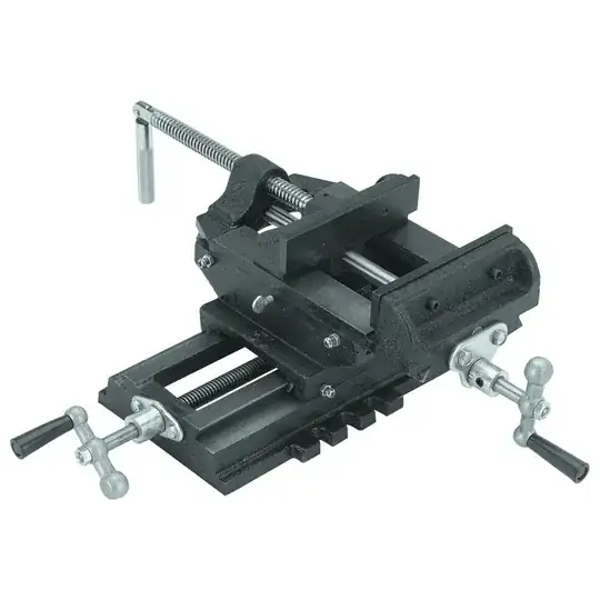

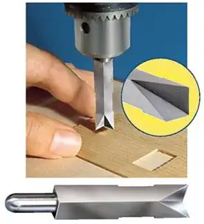

For instance you can buy some corner punches for cutting out nice square holes. These ones, for about $30, will fit in to a small drill press (just for the press portion), which you can get for about $130. For drilling precision I use a cross-slide vice mounted to my drill press. This improves the linearity of the holes I drill significantly.
So, get yourself some of the right tools and the quality of the project cases you build will be much better. You'll also only pay ~$10 for a case rather than a couple hundred for a one-off.
