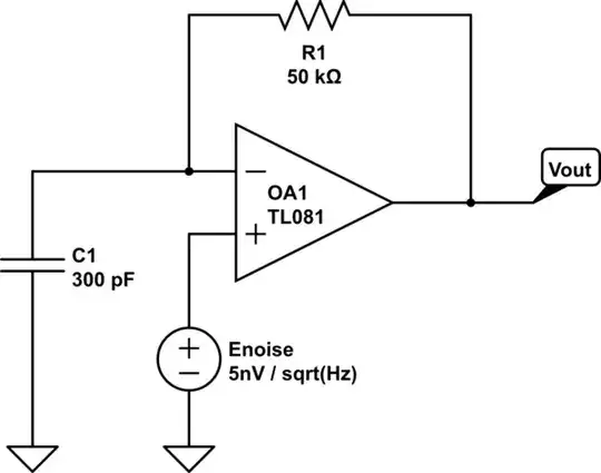

The main issue with large capacitance photodiodes is choosing the correct op-amp. It's all about choosing the op-amp with the lowest input voltage noise because this noise gets amplified significantly at higher frequencies. I'm assuming that a transimpedance amplifier configuration is used because this will normally be the circuit of choice if you want to measure light from DC upwards to some high frequency.
Even for medium speed communications (where DC isn't an issue) a transimpedance amplifier is normally used. Above 1 Gbps there is an increasing tendency not to use TIAs because of other problems.
Anyway, the basic problem is going to be op-amp input voltage noise: -
C1 is the photodiodes self-capacitance and the op-amp input noise I've put on the non-inverting input because that's the easiest way to see the problem.
Clearly at low frequency the noise is barely amplified at all but, as frequency rises the gain of the circuit becomes: -
\$1 + \dfrac{R1}{\frac{1}{2\pi f C1}} = 1+ 2\pi f C1 R1\$
If C1 is 300pF and F is 300 kHz then the noise gain is about 29 and the output will be a mess. What is done to counteract this is beyond the scope of this question but it's called bootstrapping and quite often uses a JFET - this can cut capacitance down by about 10:1 and in the example above the noise gain would become about 4.
What about the op-amp's noise current - well, as frequency rises C1 shunts this more and more so it becomes less of an issue at high frequencies than at low frequencies but at low frequencies the noise current will produce an output that is current * R1 so you have to be aware of this.

Anyhow, in short, it's not the photodiode self capacitance that causes it a problem, it's how the circuit lives with the inevitable noise gain this capacitance causes.
