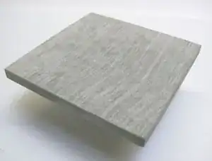

Use a 12" x 12" ceramic floor tile. It will cost you less than one US dollar but if you want to splurge you can spend another dollar and buy some small stick on rubber feet for it.
ceramic floor tile
Any ESD mat isn't necessarily going to hold up against the heat. You need a high temperature version if you're going to be using a hot-air rework station.

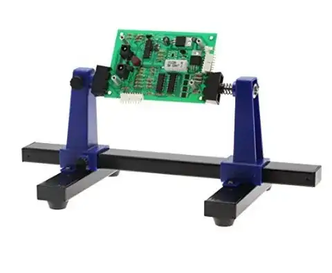

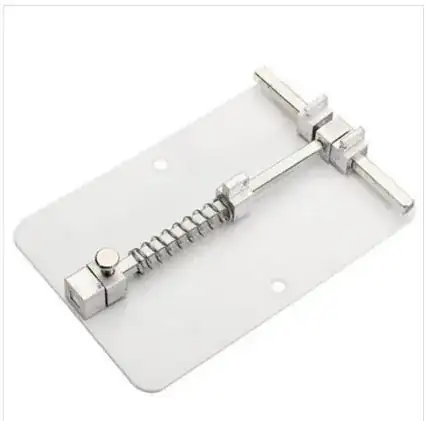

I use this very inexpensive tool: http://www.banggood.com/Fixture-Motherboard-PCB-Holder-For-Mobile-Phone-Board-Repair-Tool-p-928075.html?rmmds=myorder and it makes a world of difference! I screwed it in to a piece of 2x4 for stability. For larger boards I bought also this station: https://www.amazon.com/gp/product/B00Q2TTQEE/ref=oh_aui_detailpage_o00_s00?ie=UTF8&psc=1, but did not use it yet - my boards happen to be quite small :)
Small PCB holderSmall PCB holderHolder for larger PCBsHolder for larger PCBs
Alex Zarenin
  • 39
    You use what? There's no way to understand this answer if the links go away - this is why link-only answers such as this are frowned upon. – pipe Oct 07 '16 at 01:51
