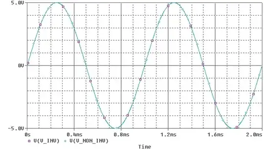

Because I couldn't believe both situations would simulate the same, I did it myself:
Ideal opamps
Just 2 opamps which are internally fed to +/-15V. They follow a 1kHz 10Vpp source. The results are: Simulation 1 (Note: Colors are inverted, so green = purple, cyan = red)
Oh so they do amplify correctly. But the ideal opamp has an infinite gain, no offset voltages, no input bias currents, no bandwith limitations (however, we wont notice much of that at 1kHz) etc. If we look at a real opamp, I picked one randomly (TL031):
Real opamps
An now it suddenly clips, because the opamp doesn't have the correct feedback.
Simulation 2

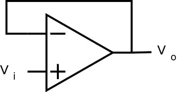

An op-amp attempts to take the difference from the non-inverting compared to the inverting and multiply it by infinity. Lets say that the gain is only 10 though(instead of the 10^5 you can reasonable expect) and work through an example. There are two major points to remember here, the feedback from the output to the inverting input is nearly instant, this is not always true, but it is a reasonable approximation for low frequencies.
The circuit:
from_http://denethor.wlu.ca/pc300/opamps_lab/opamp_buffer_label.png this circuit was pulled.
If, lets say, you instantly changed Vi from being 0V to 10V what would happen?
  1. The instant that the voltage change happens your Vi is 10V, your Vo is 0V.
  2. This means that the op-amp has a difference of 0-10 V and will attempt to start swinging towards the -100V mark.
  3. As the voltage swings towards 0V the voltage it is targeting will go down. This will happen all the way until it reaches 0V. In a no load circuit with no delay, this will be instant.
In the real world you have delay, this can cause overshoot and ringing. In the real world, you have a load, so a higher gain gate will allow a higher speed transition.
