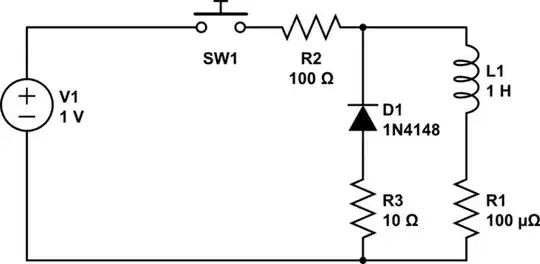

Consider a circuit as such:
R1 is the internal resistance of L1, and R2 is our charging resistance. D1 functions as the fly-back diode, and R3 is the resistance of D1 in conduction.
If the switch is closed and we wait forever, a current of 10mA flows through the circuit, and the inductor stores an energy of 50μJ (50 micro Joules).
Using conservation of energy theory:
If the switch is opened, the inductor reverses polarity to try to maintain the 10mA current. The fly-back diode is biased into conduction, and an energy of 50μJ is dissipated through the diode resistance in \$5(L/R) = 500\mathrm{ms}\$. The power dissipated in the diode is 50μJ / 500ms = 100μW (100 micro watts).
\$(1/10) (10\mathrm{mA} ^2) (10\mathrm{ohms}) = 100\mathrm{\mu W}\$
So to answer the last question: the diode current during discharge can be thought of as equal to the steady state charging current of 10mA when using the equation: \$P = 1/10(I^2)R\$. While the current during the inductive discharge actually decreases exponentially and is not a steady 10mA, this simplification will allow for quick computations of the required diode power in a circuit by knowing the initial conditions.
