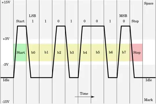

    Apparently, the development of UART character format was so dominated by the Bell telephone company that no variants sprang up. As a result, the start/data/parity/stop bit format was never the subject of an independent standard. Industry-wide usage was so uniform that no "official" definition was required. This was not true of the physical links, and so RS-232 was developed. – WhatRoughBeast May 15 '14 at 20:29
