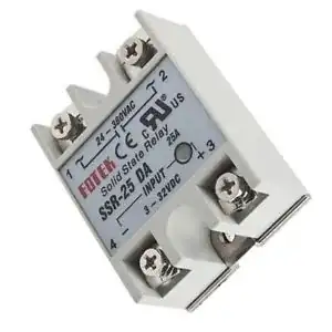

As this sounds like a one-off project and you're new to the area I'd take a look at using a solid-state relay (SSR). They tend to give good physical and electrical isolation between the mains and logic side of things so you should find it easier and safer than running 230V AC on some form of prototype board.
Most electronics suppliers carry them and they can be bought cheaply off e-bay, although buying from a reputable distributor is probably worthwhile in this case to make sure that the safety approvals are genuine. The following is an example of what they look like:
Solid state relay
