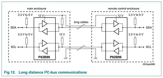

I've seen some people suggesting lowering the clock-rate to somewhere around 500 Hz, to mitigate the effects of the capacitance of such a long line I assume? The components I'm using require at least the standard 100 kHz clock-rate. I did some further research and found among answers to another question a suggestion to use a P82B96 level shifter. In the datasheet they give examples of using them on lines of even 100 meters:

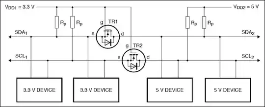

I've come across another way of shifting levels through a breakout board from adafruit, which is just a mosfet (bss138) with two pull-up resistors (one for each side/voltage). They got the idea from an application note from NXP (AN10441), and two of the channels on there could be used like this:
mosfet level shifting
Now I wonder: which solution is best? Or is there something I have overlooked? And also, is 5V enough to ensure a good connection? Would there be an advantage to using an even higher voltage like 12V?

    I know this is an old question but the bottom scheme is a level shifter, has nothing to do with long distance support for I2C. The 82B96 is the device you need. It translates a voltage to a current and that allows long distance travelling for the signal On the other side of the cable the current is again translated into a voltage to "reconstruct" your I2C signal. – GeertVc May 13 '23 at 14:27

I think you are on the right track with something like the NXP P82B96. If you have a look at Figure 14 and the associated text the datasheet discusses using cable length of up to 250 m with data rates over 100 kHz.

  • Could the P82B96 be replaced by the mosfet alternative? For the price of one P82B96 I can literally buy 100 bss138 mosfets (I can give you the links if you want). Indeed, like you said, I've found what looks like a suitable temp sensor: LM75A. As to the choice between a shielded or an unshielded cable, it seems it's a matter of which problem you want: possible interference (unshielded) or line capacitance (shielded), is this a correct assumption? Is one more prominent than the other? I have no idea how to determine this. Thanks btw! – KJdev May 19 '14 at 16:26
  • I don't think you can replace the P82B96 with the MOSFETs for long lines. It looks like the repeater IC actually provides some amplification, where the MOSFETs are primarily providing a voltage level shift. I'm afraid I'm not sure how to make the call on the cable...you should look at the NXP application note AN255. They talk about using twisted pair wiring but don't mention a shield. For digital signals the noise might be less of an issue than the capacitance. – Joe Hass May 19 '14 at 17:35
