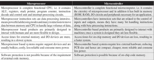

All answers are correct, as this difference more of blocks having in mC and mP, see below table,

Difference between microcontroller and microprocessor
  1. Microprocessor = cpu; Microcontroller = cpu + peripherals + memory Peripherals = ports + clock + timers + uarts + adc converters +lcd drivers + dac + other stuff; Memory = eeprom + sram + eprom + flash
  2. In Microprocessor more op-codes, few bit handling instructions. But in Microcontroller: fewer op- codes, more bit handling Instructions.
  3. A microprocessor may not also be programmed to handle real-time tasks whereas a microcontroller such as in devices that need to control temperature of water or perhaps measure the temperature of a room require real time monitoring and therefore with its inbuilt set of instructions the microcontroller works on its own.
    These informations are a little bit random and not so well formulated, for a question with so many answers. Take an example: who says that a microcontroller has to have ADC, DAC and LCD drivers? Many have them, but it's not a rule. The same for bit handling and real time operation. – clabacchio Feb 16 '12 at 07:13
  • @neelamSingh, Welcome to the site, your post did not format well and seems to cutoff partway through, it could use some work! – Kortuk Feb 16 '12 at 07:14
    Your third point is not valid. Real-time ability is determined by the OS, not the type of processor. There's no reason why a RTOS wouldn't run on a microprocessor. And microcontrollers don't have necessarily more bit handling instructions, either. – stevenvh Mar 21 '12 at 16:14
