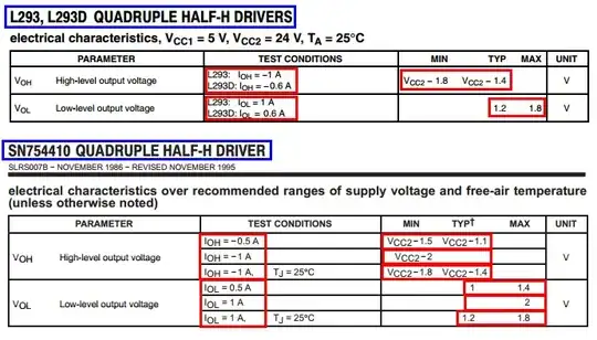

The L293 and the SN754410 are nearly identical and crucially, if you try and control a 1 amp load, you are faced with dismal performance: -
The tables tell you (typical conditions) that the upper transistor drops (loses) about 1.4 volts when driving a 1A load and, the lower transistor drops (loses) about 1.2 volts when driving a 1A load. The upshot is that if you have a 6V, 1A motor and 6V battery, don't expect to see more than 3.4 volts across the motor: -
\$V_{OUT} = 6V - (1.4V + 1.2V) = 3.4V\$
Worst case scenario is you might only see 2.4 volts across it.

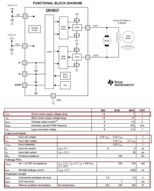

For low voltages, it seems like the DRV8837 is pretty good: -
With an 800mA load, the volt drop is: -
\$I_O\cdot R_{OS(ON)}\$ = 800mA x 0.33 ohms = 0.264 volts. At this current, the power dissipation will be 0.8 x 0.8 x 0.33 watts = 211 mW.
Compare this with the L293 power dissipation at about 800mA - maybe about 3V is lost giving rise to a power dissipation of 2.4 watts.

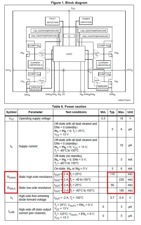

The VNH5200AS-E from ST is also pretty good and is intended for supplies as low as 5.5V up to 18V: -
Also, another offering from ST is the VN5770AKP-E. It can be configured as separate top-side and low-side MOSFETs (including drivers) or just wired as a H bridge.

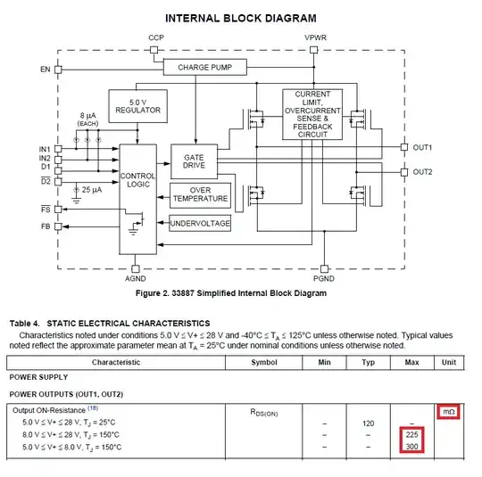

There is also the MC33887 from Freescale (formerly Motorola): -
It has on resistances in the low hundreds of milli ohms too.
