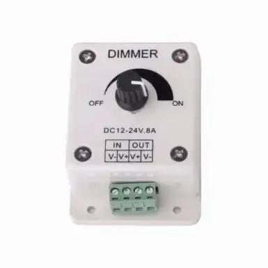

I've seen this LED Light Dimmer switch on amazon and other sites, Just wondering would it work in the same way as just giving the fan less volts and therefore slowing it down ?
However the dimmer is 8a output, Would it be safe?

The dimmer will work fine, just remember to don't exceed the 800mA maximum load current. If the PSU has a big amperage that's not a problem, but if you connect to many fans in parallel (yes you can do that!) then you might exceed the rating and fry the dimmer.
go for it!

  • The PSU is only 1a, is it ok that the dimmer is more amp? – Exoon Apr 29 '14 at 17:41
  • The dimmer seems to be .8A to me, that is 800mA, that is less than 1A. In any case that won't be a problem either, actually it would be better since breaking the dimmer would be impossible... – Vladimir Cravero Apr 29 '14 at 17:43
  • Hmm, here is the link to it, Hope its ok to link to this: http://www.amazon.co.uk/12V-14V-Dimmer-Switch-Brightness-Controller/dp/B008TNH68E/ref=sr_1_7?ie=UTF8&qid=1398792408&sr=8-7&keywords=led+dimmer – Exoon Apr 29 '14 at 17:44
  • That's 8A, as you said, so you'll just need not to exceed your psu max current – Vladimir Cravero Apr 29 '14 at 17:49
