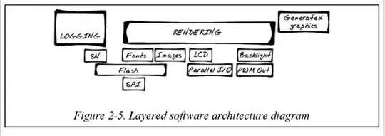

There is a semi formal approach you can use to help you generate your answer. I highly recommend reading chapter 2 of White's "Designing Embedded Systems", most of which is available at Google Books.
This chapter talks about designing system architectures, and offers a semi formal approach to how you can best encapsulate tasks. While the chapter is largely about one controller systems, it easily extends to multiple controllers. It will help you envision which resources need to be shared, and help you pick your level of encapsulation for each task.
She offers a variety of views to consider, one of which I show below, but there are many useful manipulations. This, of course, doesn't make much sense on its own, but I hope it encourages you to check out the chapter.
from White, Making Embedded Systems, Chapter 2
As to "how do I know if I have enough controller", my own preference is to put as much power into my designing sandbox as I can, and then figure out how many resources I can cut down on once the design is well on its way. The difference in price between a $10 microcontroller and a $3 microcontroller for prototyping purposes might just be weeks of retooling and twiddling your thumbs waiting for new parts, while the design can always keep moving if you have enough power.
