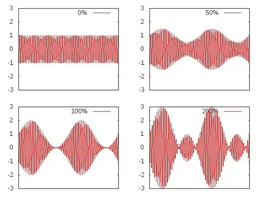

In the image below a amplitude modulated sine wave:
  • 0% unmodulated, the sine envelope is not visible at all;
  • < 100% modulation depth is normal AM use;
  • 100% modulation depth, the sine envelope touch at y=0. Maximum modulation that can be retrieved with an envelope detector without distortion;
  • > 100% modulation depth, "overmodulation", the original sine wave can no longer be detected with an envelope detector.
A still overview of the most important modulation depths (0, 50, 100 and 200%):

    The still plots appear to show moiré patterns due to aliasing, which might give the appearance of misleading (non-existent) sinusoidal waves within the waveform – binaryfunt Jan 16 '19 at 18:18
