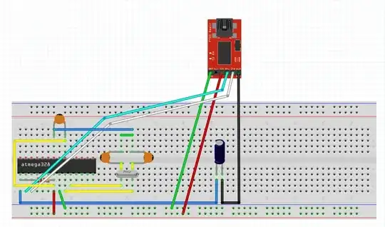

I followed exactly this setup:
  1. Connect the DTR pin to pin 1 on the ATmega through the 0.1uF capacitor.
  2. Connect the RX pin to pin 3 on the ATmega (TX)
  3. Connect the TX pin to pin 2 on the ATmega (RX)
  4. Connect the 5V pin to the 5V rail of the board to supply the board with power from the USB interface.
  5. Connect the GND pin to the GND rail of the board
Setup (from instructions being followed)

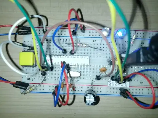

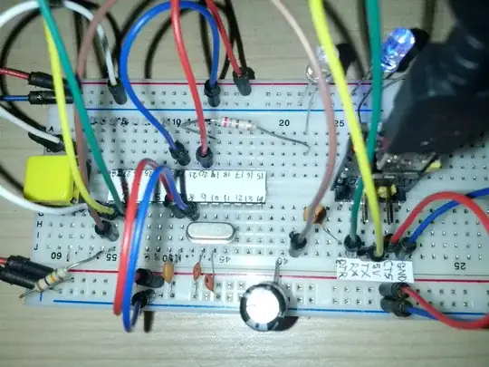

To popular demand here are pictures of my board and the USB to FTDI breakout board I am using.
Breakoutboard
My breadboard - image 1
My breadboard - image 2

  • @Ethienne You show a photo of your breadboard, presumably in the hopes of showing the wiring. Yet it's almost impossible to read the board (and chip) labeling, and the FTDI board is not the one in your first picture, nor in the eBay link, and the pinout is different. A higher-res photo of the breadboard would be helpful. – gwideman Apr 17 '14 at 09:14
  • Also, I'm now guessing that this is not actually a photo of your board, but rather a photo swiped from here: http://perhof.wordpress.com/2011/11/19/breadboard-arduinos-and-sparkfun-ftdi-basic-breakout/ – gwideman Apr 17 '14 at 09:24
  • Ethienne, it would be better to show a photo of **your** breadboard, not the one you are using as instructions. It would also be a good idea to include a schematic of the circuit (e.g. showing which 328 pins is the xtal actually connected to?) Use pencil-CAD or Ctrl+M after clicking "edit". Could you also clarify where the Mega16u2 came from and how you used it? – RedGrittyBrick Apr 17 '14 at 10:23
  • I`ve just uploaded a picture of my breadboard. – Ethienne Apr 18 '14 at 02:05

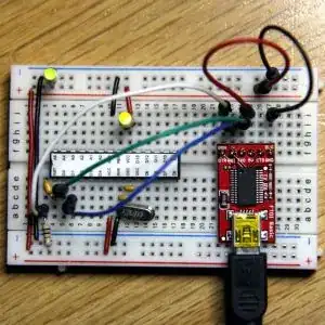

Looking at the picture you appear to be following here:
There is almost certainly an error which will cause Reset not to work as expected.
I think the Reset circuit is supposed to mimic the one in an actual Arduino, which has DTR connected via a 100nF (0.1uF) capacitor to /RESET (pin 1). The actual Arduino (eg: Deumilanove) schematic shows a 10k pullup resistor from pin 1 to +5V. This will force /RESET to become deasserted some brief time after being asserted by DTR going low.
However, on the breadboard in the photo, the 10k resistor is connected to the wrong end of the cap, attaching to DTR. This will have no effect, and means that the /RESET recovery will be only due to the in-built pullup, which is purportedly a higher value like 30 to 60k, and will thus take 3 to 6 times as long to reset, and will be more susceptible to noise.
Moving the 10k resistor pullup to pin 1 may solve the problem outright.

  • The LEDs in the higher resolution version of that [photo](http://perhof.files.wordpress.com/2011/11/arduino_breadboard.jpg) do seem to have resistors soldered to them under red heat-shrink tubing. – RedGrittyBrick Apr 17 '14 at 10:08
  • Ah, right, the first photo with the partially-completed breadboard shows that more distinctly. Thanks for pointing that out. Highly misleading for "young players" though! – gwideman Apr 17 '14 at 10:10

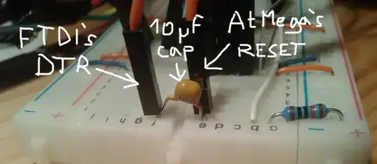

I had a very similar issue and it was caused by lousy connections on my breadboard between the FTDI's DTR --- 0.1uF ceramic cap --- AtMega328p's RESET.
The issue was solved when I inserted the male wires into the same holes as the legs of the cap, so that the connection was stronger. I was able to upload sketches, but it was still not very reliable. When I exchanged the 0.1uF cap for a 10uF ceramic cap, it seemed to fix the issue completely.
EDIT: Another issue causing similar behavior was using an "USB overcurrent protector" module between my laptop and the FTDI module. So I stopped using it although my previous laptop was burned by one of my wirings :o( Together with a tighter breadboard uploading sketches works like a charm.
DTR, cap and RESET on a breadboard
