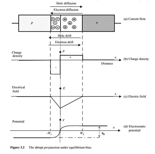

The reason I ask this though is that from my understanding of the depletion region and built in potential of a diode it seems like if you connected a voltmeter across the whole diode it would show the value of the built in potential.
This is explained in the image below:
pn junction under equilibrium bias
At first, electrons flow from the n type to the p type because there are a higher concentration in the n type, and holes do vise versa. This is called the diffusion current. The first electrons and holes to cross the pn boundary are the ones which are closest to it; these carriers recombine when they meet each other and are then no longer a carrier. This means there is a depletion region of no carriers near the pn boundary. because electrons have left the n type material, and holes have left the p type material, there is a surplus of positive and negative charge on the n and p side of the pn boundary respectively. This causes an electric field that opposes the diffusion current, and so no more electrons or holes cross the boundary and combine. In short, only the electrons and holes near the boundary combine, because after they have done that an electric field is formed that prevents any more carriers from crossing. The current due to this electric field is called drift current, and when in equilibrium this will equal the diffusion current. Because there is an electric field at the boundary (pointing from the positive charge to the negative charge) there is an associated voltage. This is called the built in potential.
If you sample the electric field at each point along the diode from left to right, you would start with 0 in the p region because there are an equal number of protons and electrons. As you approach the depletion region you would see a small electric field pointing back towards the p region, caused by acceptor impurities which now have an extra electron (due to recombination) and therefore now have a net negative charge. This electric field would increase in strength as you get closer to the boundary, and then die away as you get further away.
This electric field means there is a voltage, as shown in graph (d). The p side is at an arbitrary potential, and the n side is at a potential higher than this because there is an electric field between them. This means there is a potential difference across the depletion region; this is known as the built-in potential.
But why when I connect a volt-meter across the whole diode will I not see this built in potential?

I think it's because of the fact that the Fermi level becomes discontinuous under bias. I'm sure you can visualise that what the voltmeter is really measuring is how badly electrons and holes want to cross the junction. At thermal equilibrium, the electrons and holes have no intention of moving across the junction, so the voltage is 0V. IN other words, the voltmeter really only measures the difference in the Fermi levels between the 2 sides.
To understand why it does this, you have to know how a voltmeter works. Rather than literally measuring the difference in the energy level of an electron at both ends of the diode (which would be awesome), it just measures the current flowing through its high resistance. In a diode at thermal equilibrium, there's no net movement of any charge carriers and so there's no current. No current means no voltmeter reading.

I think, the answer is relatively simple. Do you know the working principle of a "Schottky diode", which is based on a semiconductor-metal junction? Now - what happens if you connect a voltmeter (or any other load) across the diode? You create two Schottky junctions which exactly compensate the diffusion voltage inside the pn diode. Thus, no voltage can be measured. With other words: You cannot use the diffusion voltage to drive any current through an external load.

You are absolutely right (last paragraph), because there is a change in potential due to electric field in the depletion region, there is higher potential from n-type side and negative potential from p-type side, making the intrinsic potential difference built up. That is why, to allow the current to flow through diode (PN junction) you would need higher potential from P-type and n-Type such that their difference is larger than the intrinsic potential difference which is in opposite direction to applied voltage across diode. This is what we call forward biased diode! I am sure you know this basics. Now lets go to the real question ->
If you were to probe your virtual Digital voltmeter exactly at the two depletion boundaries then I am sure you would see the voltage difference there, but its quite impossible to do with the regular multimeter. I am sure there are ways that semiconductor companies have special probes to sense these voltage differences. But if you were to measure the disconnected diode from your regular multimeter (same this is taken in consideration when you simulate it in LTSPICE that the probing is done at the ends of the diode not internally). Basically, your Graph (D) has this answer it self. Graph shows that both ends of diode have no electric field present. since the Electric field is conservative, and two diode ends (ends of P and N type materials) have no charge and electric fields at the ends are cancelled due to diffusion, as a results there is no electric field present at after the diffusion region ends, that means their difference is also 0 and measured voltage difference is 0 V as well. Hope this helps!

The answer is quite simple.The barrier potential exist across the depletion region not across the diode, so the region of existence of electric field lines is limited to the depletion region only.
The multi-meter used is connected across the terminals of the diode. And there exist n and p regions between multi-meter probe and depletion region.The unbiased n and p region acts as an insulator so as result no field lines is received at the probes so no voltage is shown in multi-meter.

Giving this question a shot. There are two types of currents at a PN junction. Diffusion currents are caused by carriers moving down a carrier density gradient. Drift currents are caused by carriers moving down an electric field. When no bias is applied to an isolated pn junction, the diffusion current moves carriers across the depletion region, building up charges on each side of the depletion region. The accumulated charges create an electric field across the depletion region, and this electric field induces a current in the opposite direction. The process naturally tends toward an equilibrium in which the diffusion current is exactly canceled by the drift current. One could model this as two equal valued current sources connected in an anti-parallel fashion. If one were to connect a volt-meter across such an anti-parallel connected pair of current sources, one would measure 0 volts.
peter
The answer is quiet simple: You confuse the electrostatic potential with the electric potential. What you measure with a voltmeter is a difference in the electric potential.
The electric potential however does include the chemical potential of charge carriers. Note: The chemical potential µ, or more precisely the gradient -grad(µ) of the chemical potential, is the "driving force" behind diffusion.
In the case of a PN junction, net diffusion of carriers occurs until the difference of the electrostatic potential between the two conductors equals the difference of the chemical potential between the two conductors in magnitude. Since both potential differences have opposite signs, their sum is zero -> there is no electric potential difference to measure, despite a non-vanishing difference in the electrostatic potential!
