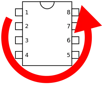

  1. DIP-style counterclockwise: DIP number scheme, taken from Wikipedia

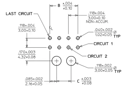

  3. Down one row then the other, but NOT counterclockwise: Molex Micro-fit numbering scheme
