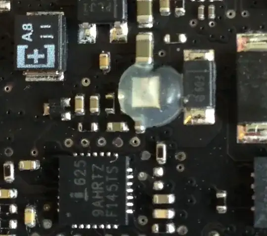

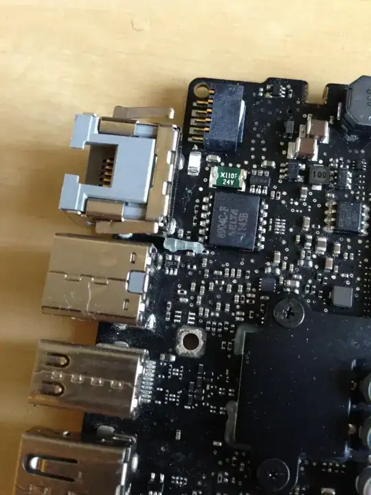

While performing CPR on a MacBook Pro exposed to water, I accidentally removed a piece of glue/epoxy from the logic board. It is a strip of glue covering two components with blank metal surfaces.
It is visible here near the ethernet port:
I found similar applications on the back-side of the logic board, more easily visible.
Do you have any idea what its purpose is? If removal may have caused damage and if it needs reapplication?

I don't know what the glue is for, but it unlikely serves any electrical function. It may have something to do with the manufacturing process. Electrically the glue should be a insulator, so replacing it with air should do no harm at these voltages.
In any case, you've got little to loose by trying to power up the board again. If it works, great. If it doesn't, you are no worse off than if it is already broken.

This type of insulation is often used in High Voltage nodes, to avoid direct touching with other circuitry and human contact. So probably that is just a HV node.
