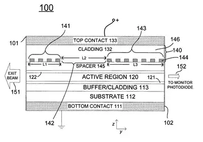

Another type you didn't ask about is the Distributed Bragg reflector (DBR) laser. A DBR typically has two separate grating regions, on either side of the gain region. They're usually distinguished from the DFB because the grating doesn't overlap the gain region, although there is some grey area and the terms are not always used consistently.
(Image source: US Patent #6638773)
Where FP, DFB, and DBR types describe how the longitudinal reflections that provide laser feedback are produced, the designation gain-guided describes how the mode is confined in the transverse dimensions. In a gain-guided laser there is no waveguide patterned between the reflective structures (end facets or DBR regions). Instead, we rely on a narrow region where current is injected to maintain the transverse mode.
This works mainly because any transvese modes that don't overlap the injection region will see much lower gain and so won't lase.

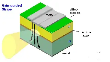

The gain-guided laser diode, as described here, uses a strip to direct current to the center of the active region to reduce the chance of edge emissions. This is usually combined with index-guiding, which is bordering the active region of a laser diode with materials with a high refractive index, this also reduces edge emissions.

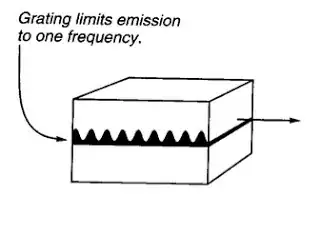

The DFB as you said, has a Bragg-grating in the active region to limit the emission to a single wavelength, since a laser actually emits multiple wavelengths called longitudinal modes.
